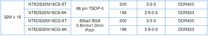

RAM
http://techreport.com/articles.x/16565
"Four Nanya RAM chips making up a total of 192MB are littered around the PCB, along with a Silicon Image PHY for HDMI 1.2 output."
NANYA NT5DS32M16CS-5T, NANYA NT5DS16M16CS-5T
DDR400 200MHz 3-3-3 66pin TSOP-II
http://forum.ixbt.com/post.cgi?id=attach:62:15348:248:1 (837x146, 20,7Kb)
