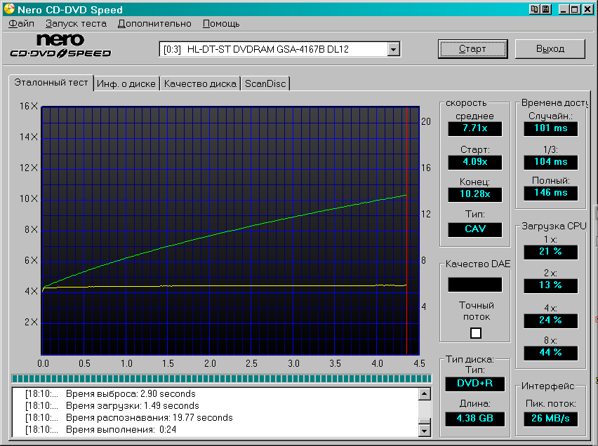

Не поленился и протестировал свой LG 4167B DL12.
Итак...
Тоже CD-R Data Disk Verbatim Pastel TY (avi-файл объемом ~700 MB):
Transfer Rate
Start 19.00x
End 48.34x
Average 36.27x
Type CAV
Seek Times
Random 133 ms
1/3 121 ms
Full 121 ms
CPU Usage
1X 17 %
2X 2 %
4X 4 %
8X 36 %
Interface
Burst Rate 22854 KB/sec
Spin Up/Down Times
Spin Up Time 4.41 sec
Spin Down Time 3.75 sec
Load/Eject Times
Load Time 1.50 sec
Eject Time 2.93 sec
Recognition Time 19.68 sec
DVD+R Data Disk Verbatim MID RICOHJPN R01
Capacity 4.38 GB
Transfer Rate
Start 4.09x
End 10.28x
Average 7.71x
Type CAV
Seek Times
Random 101 ms
1/3 104 ms
Full 146 ms
CPU Usage
1X 21 %
2X 13 %
4X 24 %
8X 44 %
Interface
Burst Rate 26304 KB/sec
Spin Up/Down Times
Spin Up Time 4.03 sec
Spin Down Time 2.84 sec
Load/Eject Times
Load Time 1.49 sec
Eject Time 2.90 sec
Recognition Time 19.77 sec
