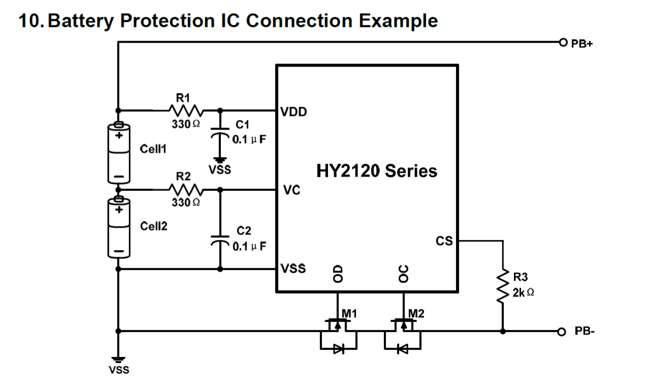

можно ли активировать BMS без подачи внешнего питания?
vlo
364/65614 ответов, #41 в рейтинге
958 фото на iXBT.photo
vlo Member
2 года назад / 14 сентября 2023 22:19
DmitryCat
дык коротнуть ключи кратковременно - считай подача.
пысы а вообще есть 2120 с некоторыми суффиксами с самовосстановлением. но когда у меня чесались руки - на али их не нашлось, толи вообще, толи по адекватной цене.

vlo
Похоже, что не всегда, в зависимости от причины блокировки иногда нужно на >VCIP (~0.2) В опускать CS, либо поднимать ячейки ещё выше:
11.3.1. Products with Power-down Function Batteries under normal operation mode, voltage of cell 1 that connected to VDD and VC pin or voltage of cell 2 that connected to VC and VSS pin drops lower than overdischarge detection voltage (VDLn) and the mode continues longer than overdischarge detection delay time (TOD) during discharging, HY2120 series will turn the OD pin output voltage from high level to low level and turn the discharging control MOSFET off (OD pin) so as to stop discharging.
This condition is called the “Overdischarge Status”. When MOSFET is off, CS pin voltage is pulled up by IC internal resistor to VDD, reducing IC power consumption value to that of in the sleep mode (<0.1uA).
This condition is called the “Sleep Mode”. The overdischarge status will be leased by two following cases. OD pin output voltage turns from low level to high level, conducting discharge control MOSFET.
(1) If CS pin voltage lowers than charge overcurrent detection voltage (VCIP) when charger is connected, voltage of cell 1 and cell 2 goes higher than overdischarge detection voltage (VDLn), the overdischarge status is released and back to normal operation mode.
(2) If CS pin voltage is higher than charge overcurrent detection voltage (VCIP) when charger is connected, voltage of cell 1 and cell 2 goes higher than overdischarge release voltage (VDRn), the overdischarge status is released and back to normal operation mode.

KaVc
так если батарея переразряжена - подключать ее и смысла нет, заряжать надо.

причина - установка банок в держатель, который подключен к BMS, желательно без сложных манипуляций включить BMS
мысль через резистор подать напряжение на какой ли о затвор, наверное на OD
Добавление от 15.09.2023 18:18:
банки конечно заряжены

DmitryCat
нет ничего постоянее временного, так и осталось: Вопрос по зарядке Li-ion аккумуляторов, #1758
но для однократного запуска после установки можно и пинцетом коротнуть, ну или кнопочку приделать.

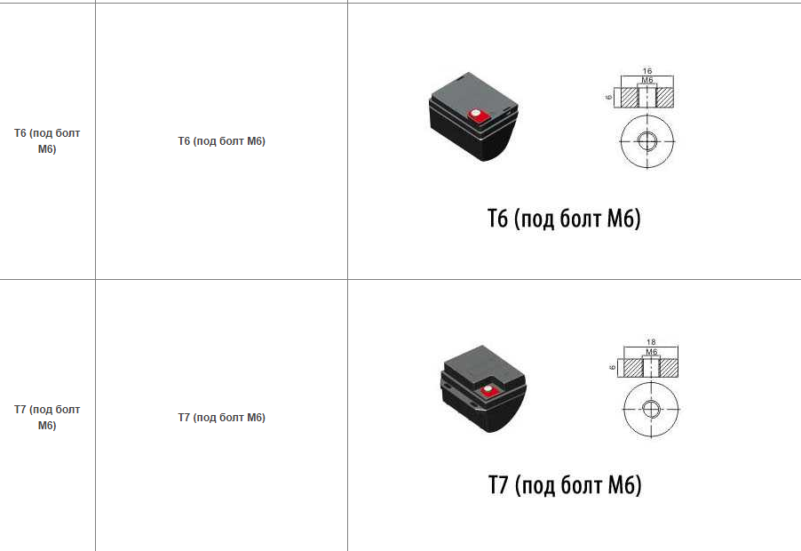

Есть акум LiFePO4 12вольт 100ампер. Есть зарядка из переделаного блока питания на 50 ампер. Клемы на акуме под болт. На зарядке крокодилы такого себе качества. При постановке на зарядку на мощность 50 ампер, температура на клемах и крокодилах по 70 градусов. Провода теплые. Сам корпус акума холодный. Это нормальное явление?

На болту болтались шайба и гровер. Болт был длинный и не прижал их. Это может быть еще одной причиной?
Наверное лучше на длиный болт по максимуму плотно накрутить пару гаек, чтоб крокодил держался плотнее?

Нужно чтобы болт не болтался в той резьбе клеммы, в которую он вкручен. Подозреваю, что греется именно там, а не под крокодилом.
Навернуть одну гайку и болт в клемме законтрить.

не совсем понял - у аккуме болт приварен или там отверстие под болт?
если все же второе и плохо затянуто, то вполне себе причина.

Есть такие клеммы в виде резьбового отверстия в аккуме - там просто резьбовое отверстие в крышке. И вот если болт в нём болтается, то именно в резьбе будет нагрев, а не под крокодилом.
Это я сейчас экстрасенса из себя строю, потому, что описания клеммы дано не было

Все правильно поняли. Отверстие под болт как на фото выше!!!
Болт прям не болтался в резьбе, просто затянул рукой, но на болте болтались шайба и гровер.

возможно стоит прикрутить клемму, а уже к ней цеплятся. т.е. что бы контакт был не по резьбе, но еще и плоскость прижата.

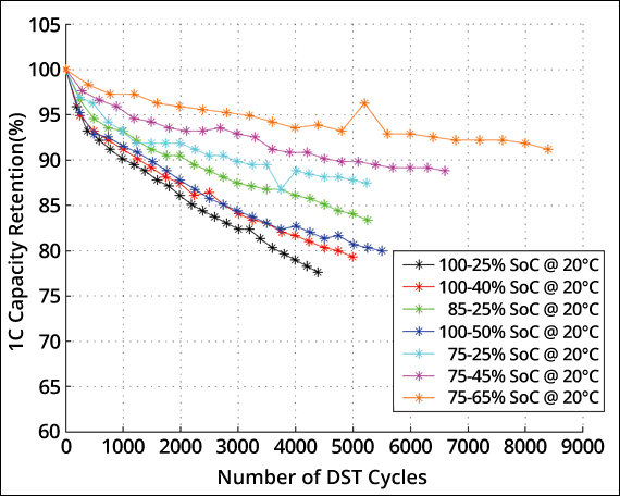

В современных девайсах массово стало появляться ограничение уровня заряда до 80-85%. По уверениям производителей - это сделает ваш аккумулятор вечным и всё такое.
А кто-то проверял эффект на практике, может статьи есть? Если тупо гонять такой аккумулятор 20-80 или 20-100% - какая будет разница в количестве прокачанной через него энергии до критического падения емкости и токоотдачи?

YMA
может статьи есть?
https://www.google.com/search?q=Lithium+soc+cycle+life
Case 1: 75–65% SoC offers longest cycle life but delivers only 90,000 energy units (EU). Utilizes 10% of battery.
Case 2: 75–25% SoC has 3,000 cycles (to 90% capacity) and delivers 150,000 EU. Utilizes 50% of battery. (EV battery, new.)
Case 3: 85–25% SoC has 2,000 cycles. Delivers 120,000 EU. Uses 60% of battery.
Case 4: 100–25% SoC; long runtime with 75% use of battery. Has short life. (Mobile phone, drone, etc.)
