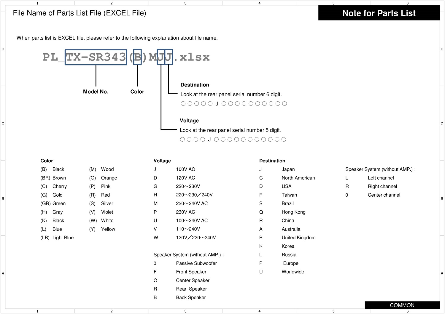

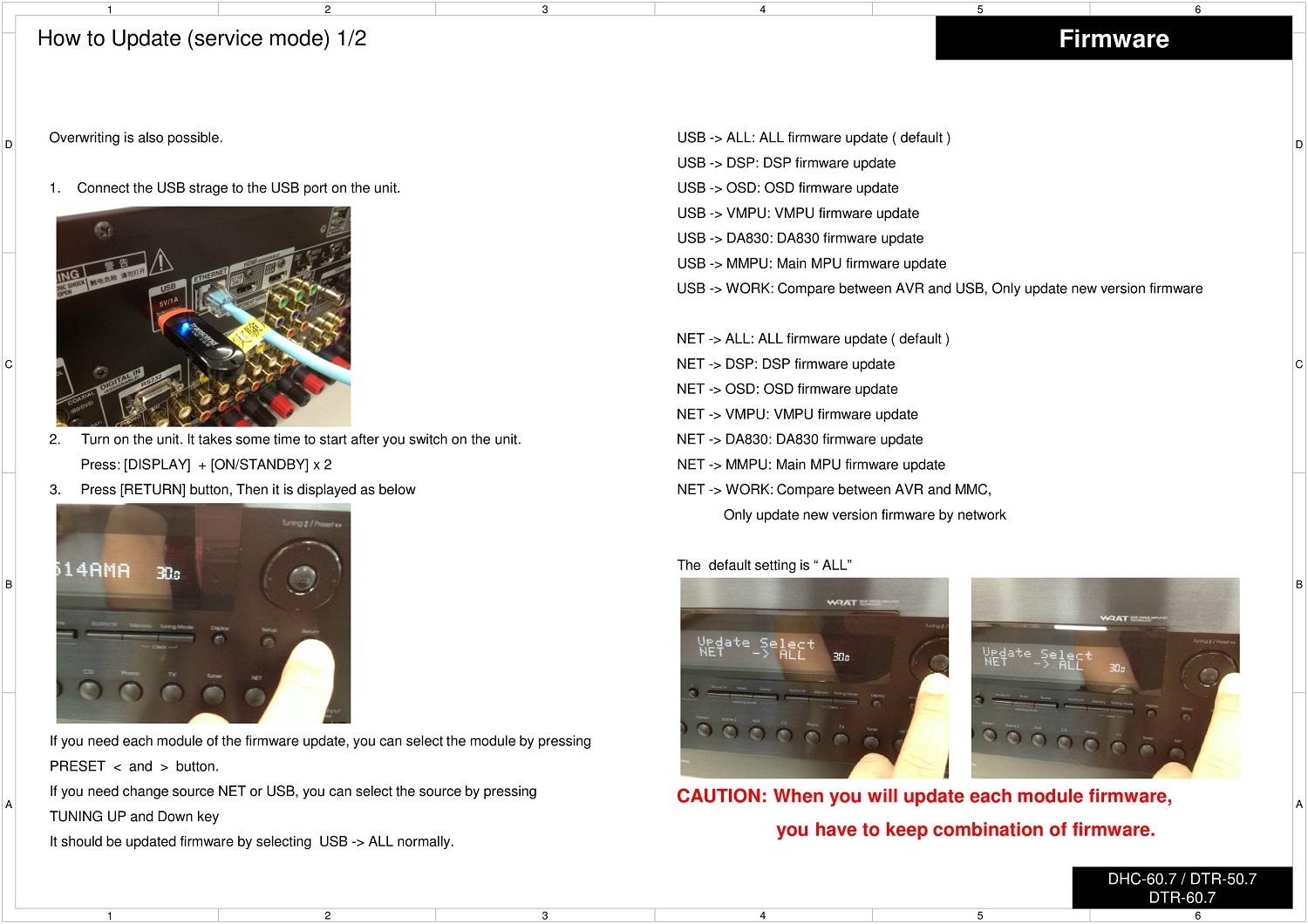

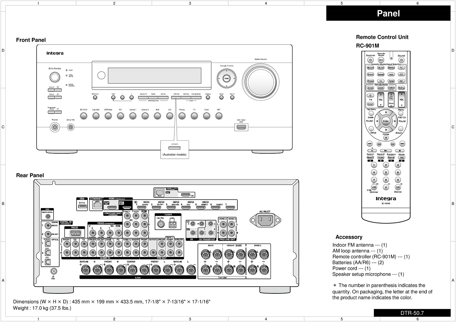

Новые SM
  1. AV RECEIVER DTR-50.7_sm_parts
  2. AV RECEIVER DTR-60.7_sm_parts
  3. AV RECEIVER DHC-60.7_sm_parts
